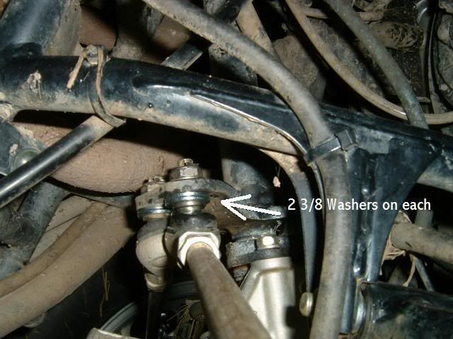

I read on another message board if you put a couple of washer between your Tie Rod it makes your steering easier. I thought I would give it a shot cause the steering on a BF 750 is kind of hard. After spending about $ 1.00 on the the 3/8" washers and a half an hour for installtion I was very suprised to see that it REALLY works.

It really does. What it does is put the tie rod in more horizontal position (less angle)

As far as you only being able to get one washer in, it could be that some washers are thinner then others makin it possible to get more in. I've read before a guy got three washers in. I tried for three but couldn't get more then two and still being able to get the cotter pin in.
You could try taking the factory washer out and see if that helps any.
You can also do the washer mod on your outter tie-rods to make it more easier.

I did the washer mod on my 750 right after I got it in July and yes it does work good. I'm runnin' two washer's on the inner tierod's and two on the outer's also.After doing this mod make sure to check/reset your toe as adding the washer's can change it a little.
